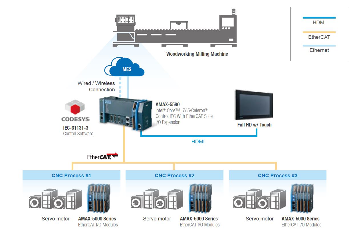

In response to the above customer requirements, Advantech jointly developed a WISE-5580 multi-station woodworking CNC solution with customer, which increased the processing rate from 2 minutes to 20 seconds, realized multi-station expansion, and connected the MES.
Solution Overview
Advantech's edge control solution, high-performance Intel processing core, using a sub-core and sub-system structure, a set of solutions integrates the Windows7 open information environment and CODESYS real-time automation kernel to achieve multi-axis motion control, CNC processing, and database and human-machine interface features. The embedded CNC function allows customers to define M-code flexibly, supports the EtherCAT bus, breaks the bottleneck of the traditional controller's axis control, and works with Shihlin Electric's SDP EtherCAT series servo motor drivers to easily realize multi-station simultaneous processing, greatly improving equipment processing rate. Modular interface expansion allows equipment to connect upstream and downstream equipment. Advantech's CODESYS database module allows equipment to quickly connect to an MES to achieve online dispatch.
  • AMAX-5580: PC-based edge controller, which can expand the plug-in I/O module and servo driver through the EtherCAT bus;
  • AMAX-5000 I/O modules: Based on the EtherCAT I/O module, 1.2 cm slim design, realizes up to 100μs real-time communication control and can be flexibly configured according to different models;
  • Advantech CODESYS PLC control software: Supports multi-axis motion control, CNC G/M code, and ODBC database protocol, can realize multi-axis open CNC control systems, connect IT and OT, and realize flexible processing through the database and MES.
Advantages
  • Integrate IT and OT to achieve flexible manufacturing: Because of Windows and the database communication feature, the customer's CAM software and MES can be integrated to realize order-based production and flexible manufacturing.
  • The number of axes is no longer a bottleneck, greatly improving the processing rate: Based on the EtherCAT bus technology, it can quickly expand the servo axis to support up to 128 axes. It can increase the original processing station to three-stations for simultaneous processing. No human intervention is required to load and unload, which greatly improves the processing rate.
  • Rich communication interface that connects the upstream and downstream stations: Advantech's edge controller supports RS232/422/485, Modbus, EtherCAT, EtherNet/IP, ProfiNET, and CANopen interfaces, which allows customers to easily connect the PLC of the upstream double-end saw and combine upstream and downstream stations to form a production line.
  • Open CNC system: The support for standard G-code and custom M-code can be used to explain to customers that they may use various high-level CAM software to meet the requirements of more orders.
