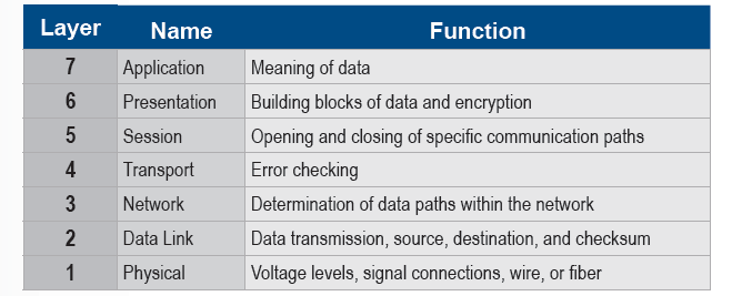

7 Layer Network Concept
[Adapted from Sensors Magazine, July 2001 ©Advanstar]
For many years, the ISO/OSI model described the layers of information in a network, particularly the low-level transport mechanisms. From top to bottom, these are the layers and how these layers relate to your product design:
1
 Most networks do not use all layers. For example, Ethernet and RS-232 are physical layers: layer 1 only for RS-232; layers 1 and 2 for Ethernet. TCP/IP is a protocol, not a network, and uses layers 3 and 4 regardless of whether layers 1 and 2 are a telephone line, wireless connection, or 10Base-T Ethernet cable.

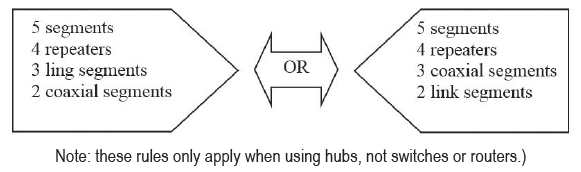

Ethernet Network Design Rule
The “5-4-3-2” rule states that the maximum transmission path is composed of 5 segments linked by 4 repeaters and, at most, the segments can be made of 3 coaxial segments with station nodes and 2 link [10Base-FL] segments with no nodes between. Exceeding these rules means that some nodes will be unable to communicate with some other nodes.
Below is a popular simplification of the IEEE 802.3 Rule regarding maximum transmission length between two nodes:
