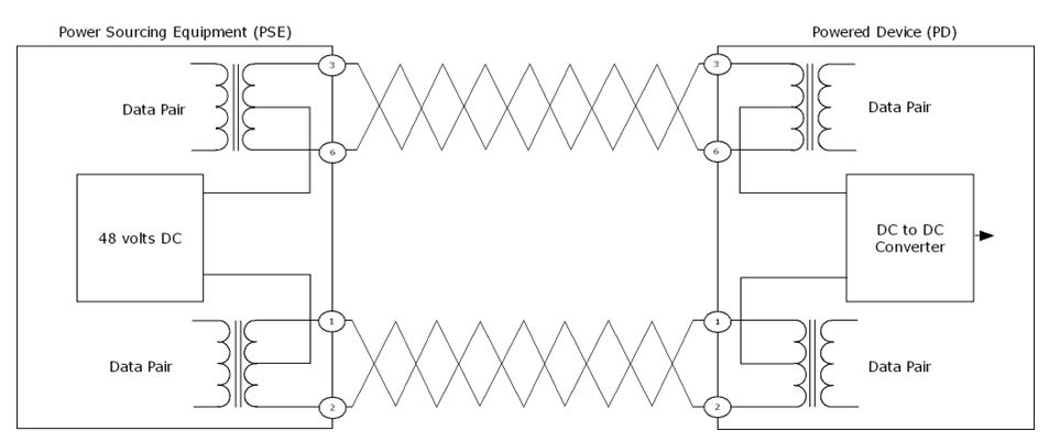

Alternative A uses a simplex or ‘phantom feeding’ method for delivering power to the end device. Power is carried on the same conductors as data. CAT-5 cabling for standard 10BaseT and 100Base-TX Ethernet uses two data/signal pairs connected to pins 1 and 2 and pins 3 and 6 on RJ-45 connectors. Power sourcing equipment (PSE)superimposes power onto these pins via the center tap of internal signal coupling transformers. In the powered device (PD), the power is derived from these lines using the reverse method.
6
Figure 1. Power-over-Ethernet - Alternative A

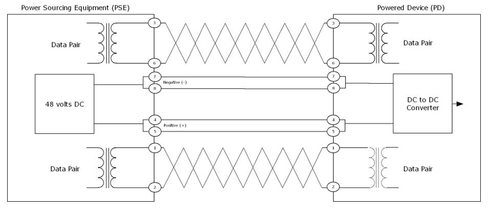

Alternative B carries power over spare wire pairs in the cable. The power sourcing equipment (PSE) applies positive voltage to pins 4 and 5. receive power voltage implemented in to pins 7and 8.
2
Figure 2. Power-over-Ethernet - Alternative B

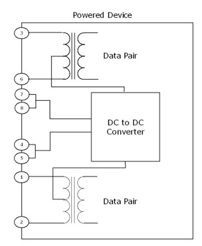

PDs are designed to accept PoE in either format(Alternative A or Alternative B) so that they can receive power regardless of which alternative is implemented in the PSE. When operating in Alternative A mode, PDsautomatically adjust for polarity of the power supply voltage. This ensures that the device will operate even if a crossover cable is being used. This sometimes happens if a Media Dependant Interface (MDI), such as a PC network card, is connected to the PD, which is also wired as a MDI.
4
Figure 3. A Powered Device

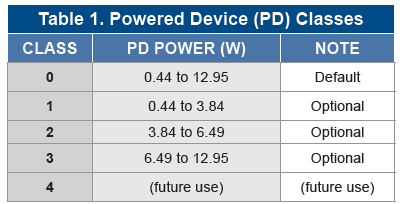

Some Power Sourcing Equipment may also detect the power class of the PD. PDs are assigned to one of the following five classes (depending on the amount of power they require):
1
If a PD does not support classification, it is assigned a default classification of 0, indicating the PSE should supply the maximum needed power. Classification of connected PDs allows the PSE to optimize its power distribution.
