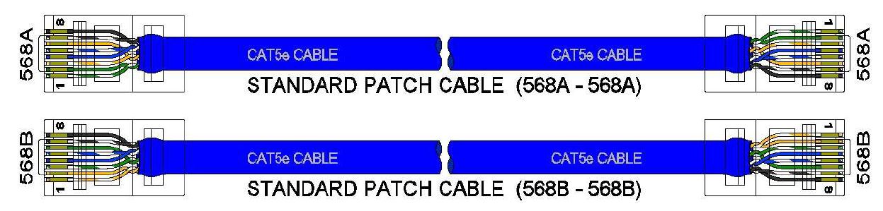

  3. Fan the wires out from left to right in the order they are to be crimped. Using the same color scheme (568A or 568B) at both ends will create a standard patch cable as shown in the 568A-568A and 568B-568B illustrations below.
  4. With the wires aligned and flattened out, use the cutting blade to evenly trim the wires while leaving approximately one-half inch exposed.
  5. With the clip facing away from you, carefully insert the wires into the RJ45 connector as shown below.

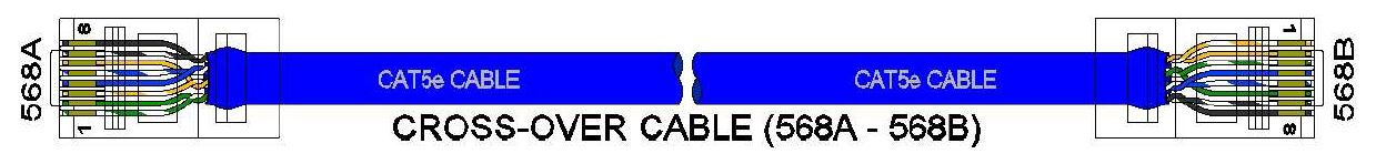

In some situations, connection of similar devices such as legacy hubs or Network Interface Cards (NIC’s) may be accomplished by the use of a cross-over cable. Therefore, the cable itself will physically perform the crossover function. A crossover cable can be easily created by using the 568A scheme at one end and the 568B scheme at the other end as shown in the 568A-568B illustration below.

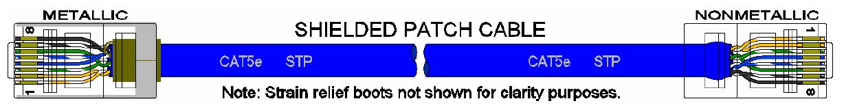

Shielded Cat5e Cable Detail
The use of shielded cables between devices is not required for most N-TRON devices (please consult the user manuals for specific details). If the use of shielded cables is required, it is generally recommended to only connect the shield at one end to prevent ground loops and interfere with low level signals (i.e. thermocouples, RTD, etc.). Cat5e cables manufactured to EIA-568A or 568B specifications are required for use with N-TRON switches.
1
In the event all Cat5e patch cable distances are small (i.e. All Ethernet devices are located the same local cabinet and/or referenced to the same earth ground), it is permissible to use fully shielded cables terminated to chassis ground at both ends in systems void of low level analog signals.
