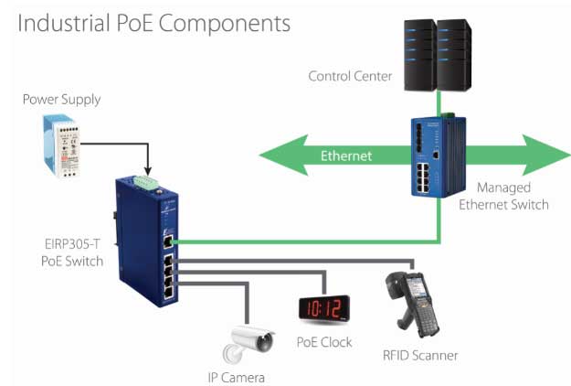

There is no technical reason why Ethernet cannot reach and power most industrial devices. Here are some of the benefits that motivate the move to PoE in industrial settings:
Cost - Using one cable for both data and power to industrial devices is cost effective – for both installation and maintenance. The cost to run a power cable can be $10 to $100 USD a foot, and changes may be frequent.
Safety - PoE is a safe power solution. Maximum voltage is under the limit for “high voltage” applications. To avoid damaging devices or accidental contact with even this relatively safe level, the PSE sends a 10 Volt test current to verify there is a 25 Ohm resistor at the PD before full power is applied. If the PD stops using power, power from the PSE stops and testing resumes. Over-current, under-current and fault protection are also part of the PoE standard.
Flexibility - PoE is
Single-cable power and data delivery, typical in

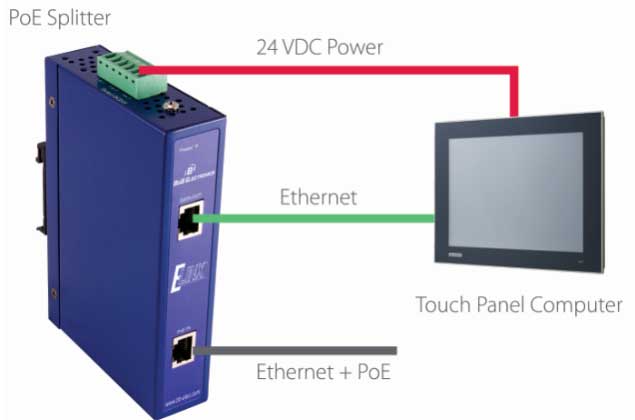

If the end device is not designed for PoE, a PoE splitter can provide separate outputs for power and data. Midspan PoE injectors can also inject power where a switch was not designed to do so, but are less common now that industrial grade PoE switches are so available.
Reliability - PoE is one means of providing power source redundancy. When added to the ability to configure Ethernet for redundant data configurations, it is a powerful combination. The complexity of combining various networks often requires more equipment, programming
Systems Integration - A simple interface, with multiple systems and locations managed via
