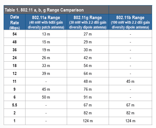

The following table provides some comparative communications distances at various data communications speeds for each of the 802.11x standards.

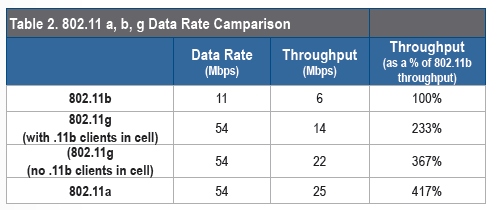

The following table provides information on data rates for each standard. Note that 802.11g systems operate significantly faster when there are no 802.11b clients in the network.

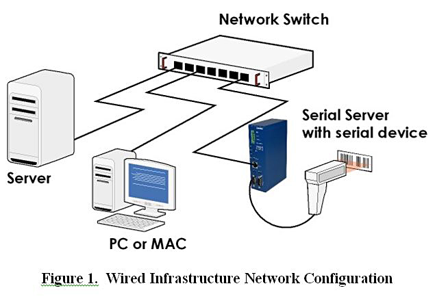

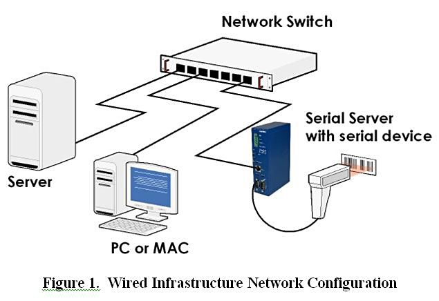

When upgrading to a wireless network, the overall layout can be somewhat confusing. In the figure below, we can see a typical wired client/server network setup, including a network hub or (more often in modern networks) a switch, a dedicated server, PC and a serial device connected to the network via a serial server. This is referred to as a “wired infrastructure configuration.”
A simpler wired network configuration (shown below) dispenses with the server and only consists of computers and other networked devices connected via their Ethernet interfaces through the hub or switch. This configuration is called a “wired peer-to-peer network.”

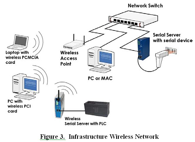

To give either of these existing networks wireless capability, connect a wireless access point (AP) to the network switch as shown in the figure below. Laptop or desktop computers equipped with wireless cards, or other wireless devices such as wireless serial servers, communicate with each other and the wired network via the AP. Wireless devices connect to the switch as if they are connected via a normal network cable. Major benefits to adding the wireless segment is that you can avoid running new cables and add up to 32 wireless computer users without having to buy a bigger switch with more ports.

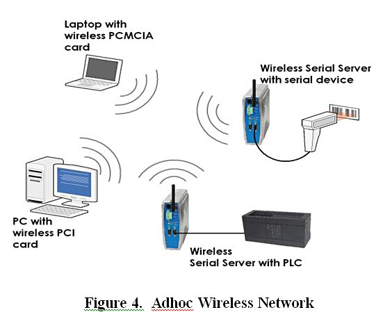

Wireless devices also can be set up as peer-to-peer, or an AdHoc network configuration, as shown below.

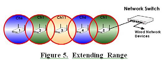

Extending the Range
WLANs have a flexible architecture. You can easily extend the range and allow seamless roaming between APs.The preferred setup method for roaming within the office environment is to install multiple APs with the same ServiceSet Identifier (SSID) and security settings, however, with each on a unique channel. 802.11x has three truly unique channels: 1, 6 and 11. You can spread out the APs in an overlapping channel layout as shown below:

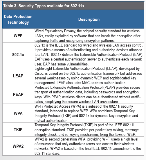

Like installing locks and keys on a door to control entry,wireless LAN security is designed to control which users can access the LAN. The following table provides a summary of various WLAN security protocols and techniques.

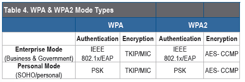

WI-FI Protected Access (WPA)
WPA was introduced as a subset of the 802.11i security standard based on TKIP. WPA addresses the weaknesses of WEP with the dynamic encryption scheme provided by TKIP. WPA dynamically generates keys and removes the predictability that intruders rely on to exploit the WEP key. WPA also includes a Message Integrity Check (MIC), designed to prevent an attacker from capturing, altering and resending data packets.
WI-FI Protected Access 2 (WPA2)
WPA2 is the certified interoperable version of the full IEEE 802.11i specification. Like WPA, WPA2 supports IEEE 802.1x/EAP authentication or PSK technology. The authentication method depends on whether Personal Mode or Enterprise Mode is being implemented. Encryption is the same in both modes. The encryption is the Counter-Mode/CBC-MAC Protocol (CCMP) called the Advanced Encryption Standard (AES). AES satisfies U.S. government security requirements.
When a user associates with an access point, a WPA2 mutual authentication process is initiated. The AP blocks access to the network until the user provides the appropriate credentials. The mutual authentication process ensures that only authorized users can gain access to the network. It also ensures that the client is connecting to an authorized server. If the user’s credentials are accepted by the authentication server, the client is admitted to the WLAN.
