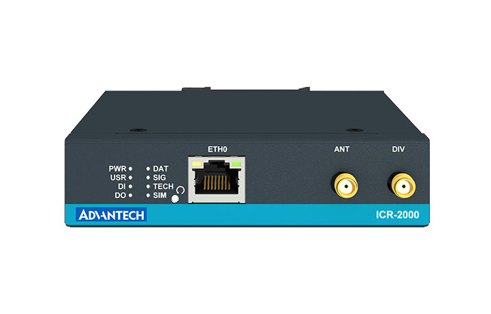

Industrial Cellular Router
From a hardware perspective, we now have a system that can read data from remote signals or sensors and leverage the cellular network to send it to any location Then, it replicates that signal as an output, creating a virtual tunnel that can reach anywhere in the world with cellular service.
Also See ...
ICR-2041 LTE Cat.4 Router with 3G fallback
  • 1× SIM
  • 1× Ethernet, RJ45, 10/100 Mbps
  • 1× DI, 1× DO
  • Wide operational temperature range
  • Wall- and DIN-mount options
  • Linux based OS & SW customization
  • Carriers support: Verizon, AT&T, T-Mobile
