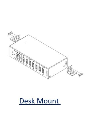

  • Other mounting method such as desk mount or wall mount.

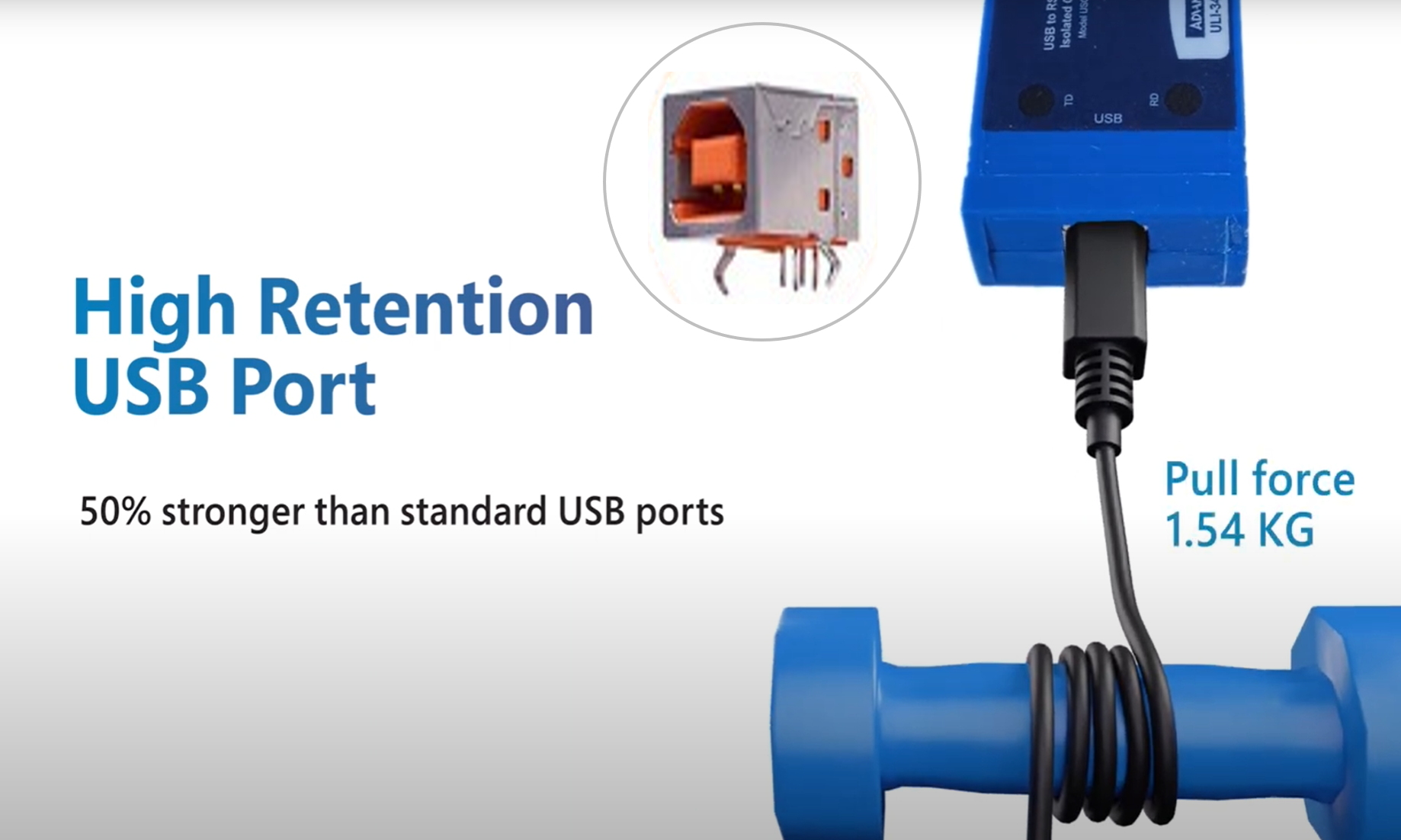

(8)  High Retention USB Connector for High Vibration Environments
Manufacturers have responded with proprietary connectors and cables featuring a custom thumbscrew. While this attempts to address the issue, it adds cost and size. Worse yet, it requires the purchase of a custom USB cable that you will not find at a local store when you are stuck on a job site.
Advantech designs high-retention USB port connectors into most USB products. The high retention ports are 50% stronger than conventional ones, so they hold tight to standard USB cable connections.
  • 50% stronger than standard USB ports
  • 1.53 kgf (15 Newton/3.4 LBS) pull force üStay connected in high vibration environments
  • Stay connected in high vibration environments
