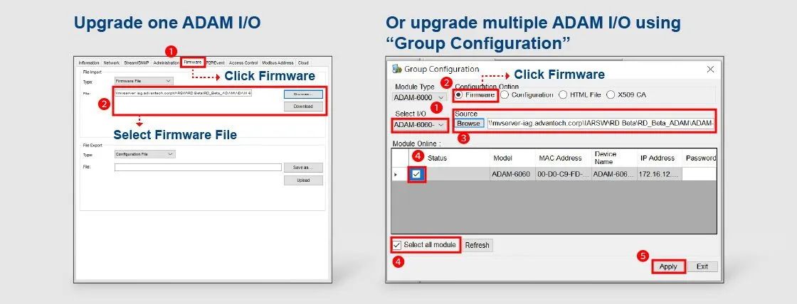

 Yes. If you are new to Advantech I/O Module Utility, you may install the latest utility and firmware in 3 simple steps.
  • Step 1. Download the Advantech I/O module Utility via this link (After V2.07.00)
  • Step 2. Download the firmware file from selecting based on your device model.
  • Step 3. Install and execute the Utility, then upgrade the ADAM I/O to the latest firmware.
Note: Use the Firmware tab to upgrade an ADAM module, or for multiple ADAM modules, easily upgrade all your devices at once by clicking 'Group Configuration' (Right-click Ethernet -> Group Configuration).

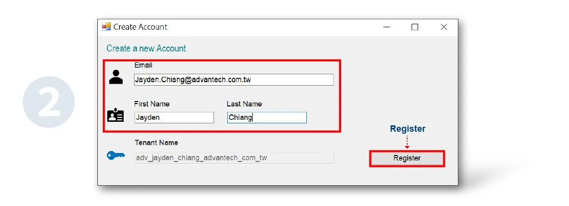

7. After installing the latest firmware, how to get started with EdgeHub?
Step 1. Click “EdgeHub” in left device tree area, then click “Create EdgeHub Account”
Step 2. Fill in the required details then click “Register”, you will receive the log in password via email.

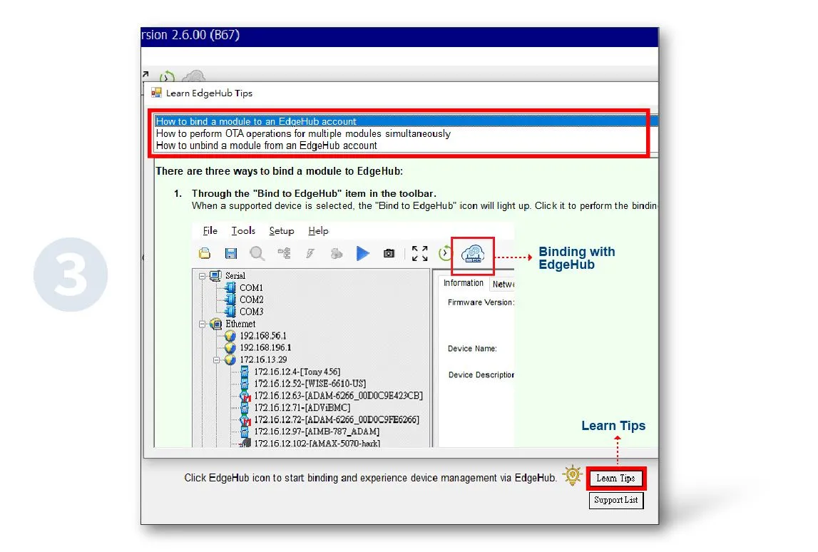

Step 3. After logging into your EdgeHub account, bind all ADAM I/O to EdgeHub using the utility during each site installation. After binding, you can manage all connected ADAM I/O across sites seamlessly through the utility. For more details, refer to "Learn Tips."
