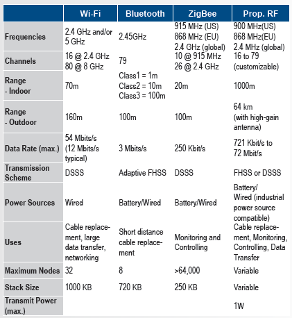

Below is a chart that compares various aspects of wireless solutions:
9
If circumstances allow you to select a RF standard or off-the-shelf solution, then your options are fairly clear. In terms of range, penetration, frequency, data rate, you have a set base line to choose from. However, if your environment cannot be modified to fit these standards, you will need to consider proprietary RF. Here are some important things to consider:

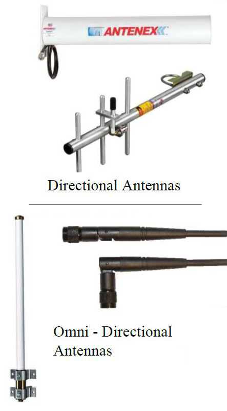

Antenna Considerations
Antenna selection will depend on your communication needs, with system array and range being the biggest factors. There are two basic types of antennas:
Directional – Sends and receives the signal in a single direction. Think of a football shape, with antennas located at either end of the football. This imagery is important because interference can occur at any point within the spectrum. This antenna will give you the largest range. Examples: Yagi, Dish, and Panel.
Omni-Directional – Sends and receives the signal in a linear radius. Think of a doughnut with the hole being the location of the antenna. This antenna will allow the largest number of nodes. Examples: Vertical Omni’s, Ceiling Domes, and Rubber Ducks.
