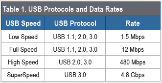

The USB standard has undergone several revisions – each impacting bandwidth, speed, data rate and more. The USB 2.0 standard calls out three speeds. The first two speeds are carryovers from the earlier USB 1.1 standard: Low Speed and Full Speed. When USB 2.0 came out, High Speed was introduced. USB 2.0 is also backwards compatible with the lower USB 1.1 speeds. The naming convention can cause a bit of confusion because “Full Speed” is lower than “High Speed.”
 Lastly, USB 3.0 “SuperSpeed” adds even higher data rates, more downstream device power, plus smart charging/powering.
Table 1 below shows actual data rates at various USB standards.

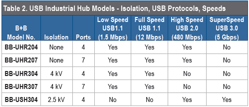

Adding isolation limits bandwidth to “Full Speed” or 12 Mbps. While this is still technically USB 2.0, the host controller will not pass data at “High Speed” or 480 Mbps. It will automatically step down to 12 Mbps. Luckily, most industrial applications will work well at 12 Mbps. If you require 480 Mbps “High Speed,” you should not use isolation or, perhaps, you might consider USB 3.0 SuperSpeed. B+B SmartWorx offers USB 2.0 Hubs and USB 3.0 SuperSpeed Hubs, plus isolated and non-isolated options as shown in Table 2 below.

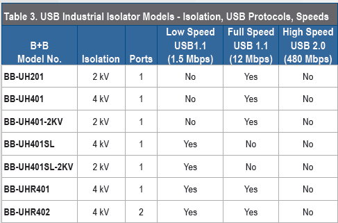

B+B SmartWorx also has a selection of one or two port USB isolators. The UH4xx product series are fixed at either 12 Mbps or 1.5 Mbps speeds. This is an important distinction because “Low Speed” isolators will not work with “Full Speed” devices and vice versa.
The UHRxx isolators also contain a USB hub chip. The addition of the hub chip makes them “smart” in that they can self-select between 1.5 Mbps “Low Speed” and 12 Mbps “Full Speed.” None of these isolators are capable of operating at “High Speed” 480 Mbps. The following Table 3 shows bandwidth capabilities of B+B SmartWorx USB port isolators.

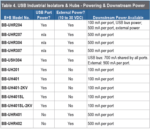

Power
Another aspect to consider is the power requirement. B+B SmartWorx isolated USB hubs, both four and seven port versions, require the use of an external power supply. As a powered hub, they provide 500 mA through each port to power downstream devices.
Models UH201 and UH40x series isolators do not have an external power option and are limited to 100 mA downstream power.
Model BB-UHR204 has the added option of operating in a USB bus-powered mode. In this mode, downstream power is limited to 100 mA from each port.
Models UHR401 and UHR402 must be powered from an external source and provide 500 mA downstream power from each port.
