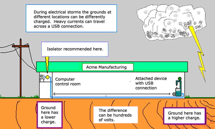

It is very useful to be able to connect a remote device via USB. But the greater the distance between the connected devices, the more likely it becomes that the communicating devices will be getting their power from different building ground references. When they do, the USB cable’s ground wire can create a ground loop path.
In home/office environments the ground loop problem is rarely an issue. The connected devices will normally be quite close, usually sharing a wall outlet and a common ground. But industrial installations can be far more complex. Imagine a situation in which a process control system is powered from a source in one building location, but the front panel is powered somewhere else. When you connect a PC to the front panel via USB, powering the PC at the same location, you can create a ground loop with the process control system, which may be hundreds of meters away. Magnetic flux from motors or other high-power devices can use this ground loop to induce current noise on the ground. If you are lucky, the only result will be data transmission errors. More extreme events, like surges and voltage overloads, will burn out integrated circuits and connectors. (See Figure 1.)
5
Figure 1. Ground voltage differences - potential for ground loops.

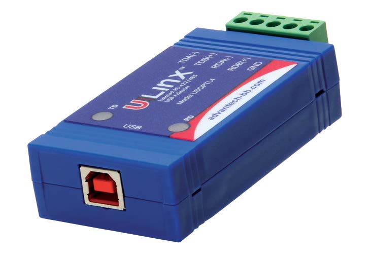

Your computers and connected devices should be protected with USB isolators. Ordinary surge suppression tries to limit spikes between the signal and ground line. But if the ground line rises, as it does in ground loop situations, then surge suppression will not stop it. Isolation allows the lines to float while keeping the local side at the proper ground and signal level. An isolator controls electrical flows while simultaneously ensuring that your data stream is not interrupted. You can deploy dedicated inline USB isolators as well as USB devices that perform additional functions while including isolation, like isolated hubs or serial converters. (See Figure 2.)
Figure 2. USB inline isolator with high-retention USB port.

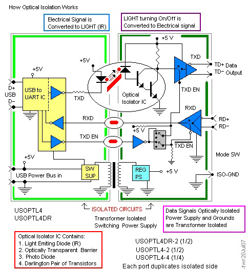

Isolation works by changing the nature of both the data signal and the 5 VDC power carried by the USB cable. The data enters the isolator as an electrical signal, is converted to either pulses of light or an electrical field, then back to an electrical signal again. The data flow is uninterrupted, but power surges and ESD are stopped cold at the isolation zone. (See Figure 3.)
1
Figure 3. How optical isolation works.
The isolator protects against surges and ESD on the power line by briefly transforming the 5 VDC USB power to AC, through an isolation transformer, then back to DC again.

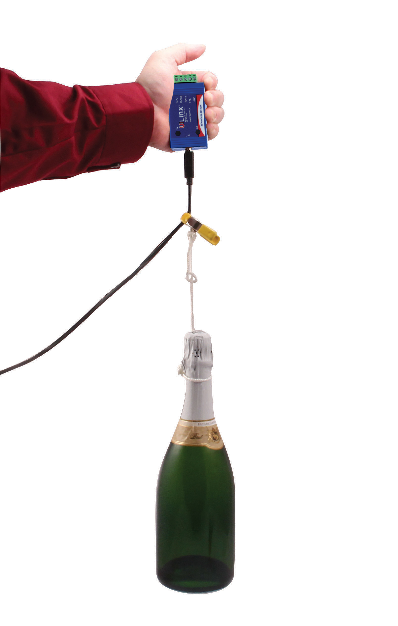

A more elegant solution employs “high-retention” USB ports. They will work with any cable and they retain USB’s quick connect/disconnect feature. The difference is that it requires more force to dislodge them. The high-retention ports used by B+B SmartWorx, for example, hold a cable securely enough that it requires 15 Newtons of force (3.2 lbs) to remove one – so securely, in fact, that they will meet UL requirements for Class 1 Division 2 Hazardous Locations. (See Figure 4.)
3
Figure 4. High-retention USB ports grip standard USB cables tight.
