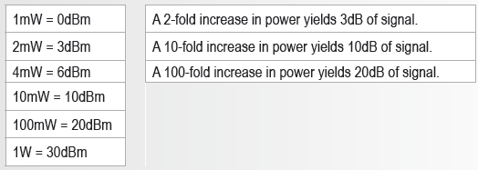

1. Basic Logarithms
Radio Frequency (RF) power is measured in milliwatts (mW) or, more usefully, in a logarithmic scale of decibels (dB), or decibels referenced to 1 mW of power (dBm). Since RF power attenuates as a logarithmic function, the dBm scale is most useful. Here are some examples of how these scales relate:

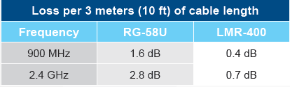

9. Use good cable in the shortest possible segments.
High frequencies do not propagate well through cable and connectors. Use high quality RF cable between the antenna connector and your antenna. Ensure that all connectors are also high quality and that they are carefully installed. Factor in a 0.2 dB loss per coaxial connector in addition to the cable attenuation itself. Typical attenuation figures for two popular cable types are listed below.
6
While long cable runs to an antenna create signal loss, the benefit of elevating the antenna another 7.6 meters (25 ft) can more than compensate for it.
