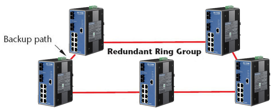

Redundant rings are connected in a loop. One link is disabled until it is needed:
1
Figure 3. Redundant Ring Group of Switches
This solution has lower cabling costs and faster recovery from a failed data pathway. These, along with support for other switches if one fails, are reasons that the redundant ring is the clear choice for industrial settings.

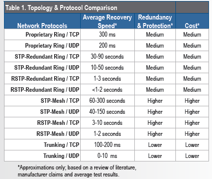

REDUNDANCY, RECOVERY & COST COMPARISON
While real-life networks may require additional redundancy measures, all are subject to the trade-offs of protection vs. resources.
It is impossible to fill in the blanks precisely. The combinations and variations of redundant networks could fill volumes. Results for every piece of equipment and network will vary. But, every situation will use the same type of analysis.
Here is a comparison overview of the topologies and protocols reviewed in this paper:
