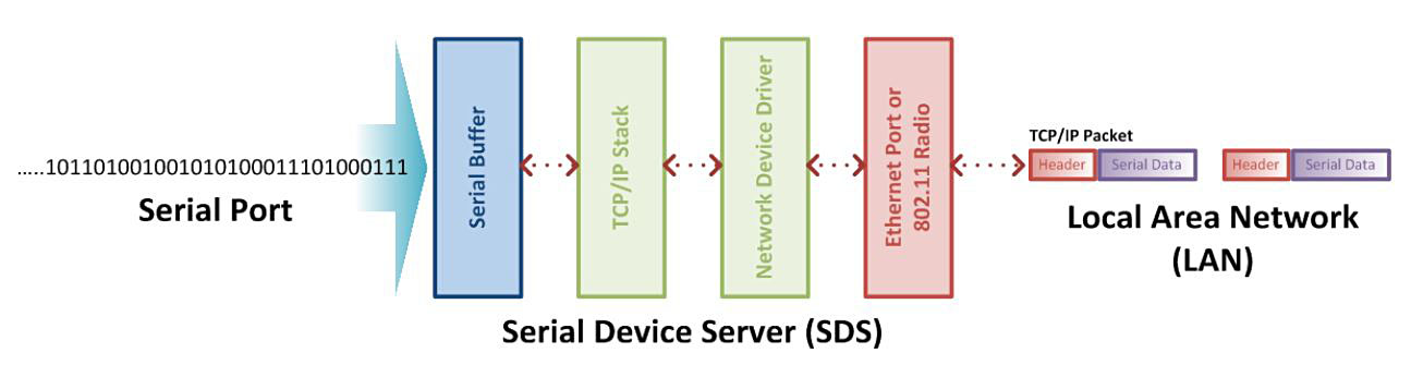

Serial Device Servers (SDS) can be wired or wireless. The most popular types are network or TCP/IP device servers. In either case -- wired or wireless – the serial server translates the serial data into an Internet Protocol (IP) format that can be transmitted across a network.
Wired serial device servers use Ethernet cable to connect to the local area network (LAN).
Wireless device servers contain a Wi-Fi client similar to the one in your laptop and connect via Wi-Fi or 802.11. The most common standards are 802.11b/g and 802.11b/g/n. Wireless servers can connect to either an Infrastructure network or an AdHoc network.
When the serial device server network interface is connected to a LAN, it provides an IP address that all other network devices can use for sending and receiving information. This address is unique to the SDS. Since this address is the location for all interactions, a secondary reference is used to locate the information or resource required for the specific interaction. This is called a “port number.”
By using the combination of an IP address and port number, it is possible to uniquely locate any serial port on the network. It works like this: a serial device server has a physical serial port connected to port 8023 on the network interface. The network interface connects to the network and gets an IP address of 192.168.2.100. After combining the two pieces of information the full address of the serial port would be 192.168.2.100:8023. Any network connected device capable of accessing that address can receive data from – or send data to – the serial port. See Figure1.

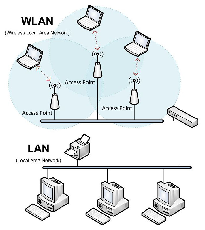

Current network serial device servers are designed to be used with an existing network infrastructure. If you have a manufacturing facility, warehouse or office, chances are you already have a network installed – wired, wireless or both. Connecting to these networks has become much easier with the latest versions of SDS technology. See Figure 2.
      Figure 2. WLAN/LAN Network
WLAN
A wireless network uses Access Points to connect a variety of computers and equipment, allowing them to share resources and information. Referred to as Wireless Local Area Networks (WLAN), they use the Internet Protocol (IP) suite for data communication between computers, networks and devices.

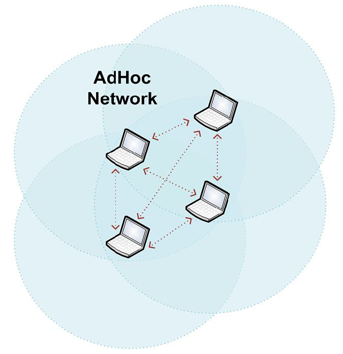

Historically, another wireless network type called AdHoc has been used where no available infrastructure network exists. AdHoc is a peer-to-peer based network that does not use a central resource (access point) to manage the network connection and structure. AdHoc networks can be established when just two clients are within range of each other, with each group of devices being referred to as a “cell.” They use the Internet Protocol suite for data communication between the devices in the AdHoc network. See Figure 3.
1
     Figure 3. AdHoc Network
However, AdHoc has certain issues:
  • Static IP Addresses are needed. A service called DHCP (Dynamic Host Configuration Protocol), often used on large networks to provide IP addresses to the devices connected to the network, is not usually available on an AdHoc network. This has several drawbacks:
    • It requires manual assignment and distribution of unique addresses to devices.
    • It creates a static subnet for the network and for all devices on the AdHoc network. This restricts interaction between different networks.
    • It requires manual configuration of IT (laptop) equipment when connecting to the AdHoc network. Personnel are required to enter a static IP address.
  • AdHoc networks are not self-healing. Even if you have multiple AdHoc networks in the same geographical location and they are using the same network name, devices in one network cannot talk to devices in the other network. Therefore, this can limit or prevent access to serial data.
There is an additional issue with AdHoc networks. The latest Android™ tablets and smart phones do not connect to them without modification of the devices. There are also known issues with certain iOS devices that make it impossible to use them with AdHoc networks that employ wireless SDS’s, which forces users to carry bulky laptops for remote access.

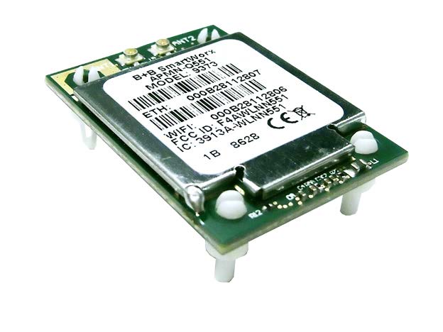

There is technology that supports embedded access point functionality – without changing SDS functionality. For example, B+B SmartWorx SDS technology features an embedded access point device (see Figure 4) that creates a small, self-sustaining Wi-Fi network around remote equipment that is not all that different from the hotspot in a coffee shop.
As your technician comes into range of the network, his smart phone or Wi-Fi tablet sees the network, connects to it and receives an IP address from the embedded AP. His device can then access the serial port on the AP using the appropriate IP address and port number. It does not change the way the SDS devices are used – it just makes them easily accessible to tablets and phones.

The example device from B+B SmartWorx (see Figure 4) can support up to two serial devices, an Ethernet 10/100 network and multiple wireless clients simultaneously. It provides WPA/WPA2 security and an embedded DHCP server. Both an embedded module and an external boxed version are available.
